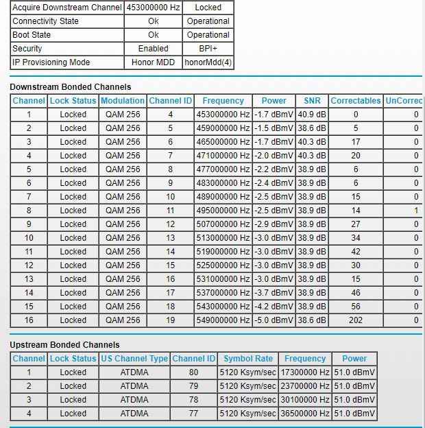

do you have a screen snip of the cable connections page when its hooked up for both locations? that lets us take a look at the signal. It wouldn't be the first time wiring within a home had issues.
- Skoot3rAspirant
So this is the screen snip for my cable connection screen when it is plugged in downstairs, however I can't even get a screen snip of the page when its upstairs because it claims my modem is offfline, so this screen doesn't show up in the first place.
