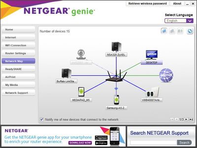

      An alternative to that cumbersome process is to look for the IP address if the wifi from the router.
      Even better, install the desktop genie for your PC.
      genie | Product | Support | NETGEAR
      Be warned, it is in a RAR file that you have to unpack.
      This will then offer a network map showing the IP addresses of attached devices. With luck there will even be a clickable link to your AP.
