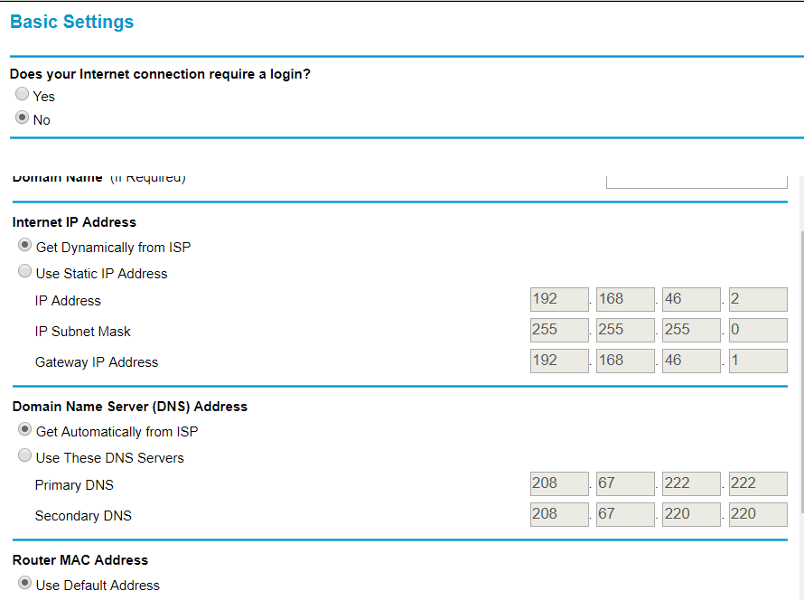

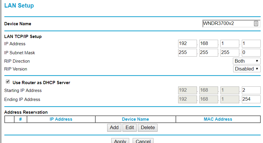

I have a WNDR3700v2 that I want to use as an access point only.  I have an an Ubiquiti EdgeRouter-X (ER-X) that I'm using to load balance 2 internet connections.  I want the ER-Xto take care of DHCP for everything on my network.  The Netgear should only take care of WiFi.  I want the DHCP on my Netgear off so only the ER-X is providing IP addresses.  But I can't get it to work that way.  With Netgear's DHCP off, the WiFI doesn't have an internet connection.  If I enable DHCP on the Netgear, then WiFi does have an internet connection, but it's giving out IPs on the 192.168.1.x subnet.  I want the ER-X to take care of all the IP leases.
I have the ER-X connected to the Netgear's WAN port. ER-X's IP is 192.168.46.1.  DHCP settings on the ER-X is 192.168.46.100-243.  ER-X is setup to assign the Netgear the IP of 192.168.46.2 which it does knowing the Netgear's MAC address.  Below are a couple screenshots from the Netgear setup.  I'd appreciate any suggestions to getting this working.

    > [...] I have the ER-X connected to the Netgear's WAN port. [...]
       Nope.  A wireless access point is all-LAN; it acts a as a network
    switch, with wireless capability.  The WAN/Internet port of the
    WNDR3700v2 is part of its router functions, and should be ignored.
       For one step-by-step, see:
          https://community.netgear.com/t5/x/x/m-p/1463500
    That's written for a C6300, but the steps are about the same for any
    other router (any make/model) which lacks a one-step WAP option,
    including yours.  But, other than the WAN/LAN port error, the rest
    sounds ok to me.
    > [...] Below are a couple screenshots [...]
       In-line images in these forums must wait for moderator approval, so I
    can't see yours yet.  (An attached file incurs no such delay.)  Some
    little description would be nice, even if the pictures were visible.
    Copy+paste is your friend.

      Thanks. I moved the cable from the WAN port to a LAN port, then set my Netgear router's IP in the LAN settings to 192.168.42.2.  Everything is working now.
