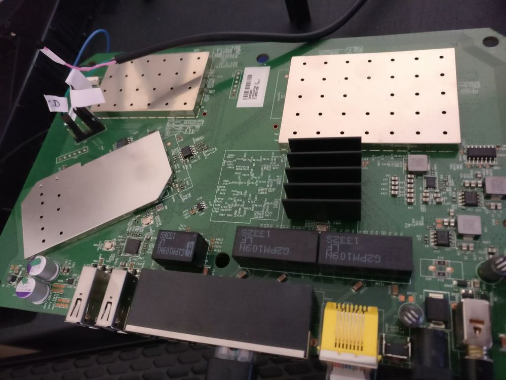

    Thanks to AndyOxon I succeeded to unbrick my router!
    I bought this cable (2.46€): niceeshop(TM) PL2303HX USB TTL Pour UART COM RS232 Câble Module Convertisseur (Noir, 1m)
    https://www.amazon.fr/gp/product/B00F167PWE/ref=oh_aui_detailpage_o01_s00?ie=UTF8&psc=1
    And I connect it to the router like here, switching TXD and RXD:
    https://www.myopenrouter.com/article/how-set-serial-console-netgear-wndr4500v2
    1- nothing
    2- TXD, green cable
    3- nothing
    4- nothing
    5- RXD, white cable
    6- GND, black cable
    I connected my laptop with the router on Ethernet port LAN1, and on USB with the PL2303HX cable.
    Then, on my laptop, using Linux and picocom:
    picocom -s 115200 /dev/ttyUSB0
    I started by doing a normal boot and waited for a shell. Then, I kept CTRL + C on the picocom prompt and rebooted (physically) the router. A CFE prompt has appeared. I executed the following command:
    CFE> nvram erase
    *** command status = 0
    In another shell on my laptop, I connected in TFTP on the router:
    tftp> connect 192.168.1.1
    tftp> mode binary
    tftp> timeout 90
    tftp> put WNDR4500v2-V1.0.0.62_1.0.39.chk
    Do not hit enter after the "put" command!
    Back to the CFE shell in picocom:
    CFE> flash -noheader : flash1.trx
    Press Enter and very quickly switch to the shell with TFTP and also press Enter to validate the "put" command.
    Reading :: Done. 12804154 bytes read
    Programming...done. 12804154 bytes written
    CFE> reboot
    Decompressing...done
    and then... it does not work for me... yet.
    This boot ends with:
    Checking crc...Invalid boot block on disk
    Start TFTP server
    Reading ::
    Go back to the TFTP shell and execute the "put" command again. Into the picocom shell:
    And now it's all good! The router is fully functional using firmware 1.0.0.62_1.0.39 (and telnet backdoor is still here...).

    • Christophe56's avatar
      Christophe56
      Thank you ElaineM. Unfortunately, the router is no longer under warranty.
      I ordered a USB to RS232 cable, but in the meantime I managed to get a shell on the router.
      Using the netgear backdoor described here, with the Python (UDP version) script:
      https://wiki.openwrt.org/toh/netgear/telnet.console
      https://github.com/insanid/netgear-telenetenable
      ./telnetenable.py 192.168.1.1 <routermacaddr> admin password
      Sent telnet enable payload to '192.168.1.1:23'
      root@eeepc:/# telnet 192.168.1.1
      Trying 192.168.1.1...
      Connected to 192.168.1.1.
      Escape character is '^]'.
      BusyBox v1.7.2 (2015-06-04 17:07:24 CST) built-in shell (ash)
      Enter 'help' for a list of built-in commands.
      However, I can not launch the http server manually. Here are the error messages:
      # httpd -E /usr/sbin/ca.pem /usr/sbin/httpsd.pem
      Can't find handler for ASP command: eco_get_redirect_link();
      Can't find handler for ASP command: cdl_cgi_set_hijack(0);
      Can't find handler for ASP command: cdl_cgi_set_hijack(1);
      Info: No FWPT default policies.
      rmmod: l7_filter
      insmod: cannot insert '/lib/modules/2.6.22/kernel/lib/MultiSsidCntl.ko': Success (17)
      ioctl(BRCTL_SET_BCMCTF_ENABLE): Operation not supported
      rmmod: /lib/modules/2.6.22/kernel/lib/AccessCntl.ko
      [AFP]: 0 partitions found.
      [AFP]: disk mountd:0 hfsplus mounted:0
      [AFP]: no disk mounted.
      killall: bftpd: no process killed
      httpd: socket bound in 0.0.0.0:80.
      httpd: socket bound in 0.0.0.0:443.
      httpd_sig_usr:6060
      buf:
      handle_genie: don't know how to process url
      and httpd kills itself.
      I think the interesting error is "httpd_sig_usr:6060" (httpd received a bad signal?)
      If I put an HTTP request into /tmp/tmp_http_request.txt I can remove the handle_genie error and get a new one:
      # echo "GET shares HTTP/1.0" > /tmp/tmp_http_request.txt
      # echo "Host: routerlogin.net" >> /tmp/tmp_http_request.txt
      rmmod: l7_filter
      httpd_sig_usr:6060
      buf:GET shares HTTP/1.0
      SendData3Client:763 error sending data.
      But httpd is still killed...
      erase nvram and reboot does not resolve the problem too.
      - Does this problem talk to anyone?
      - Can I flash the firmware from this console? Currently the firmware on the router is 1.0.0.60/1.0.38 and I would like to update it to 1.0.0.62/1.0.39, hoping that the update fix the problem. I am able to upload WNDR4500v2-V1.0.0.62_1.0.39.chk to the the router using wget but I don't know how to tell the router that it should apply it.
