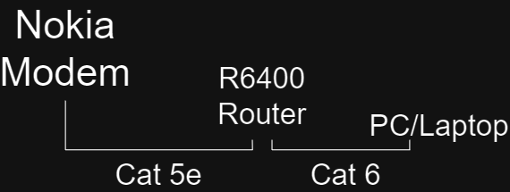

Good afternoon folks, I'm new to the forums and new to home networking in general. I tried searching the forums and online for solutions but I got mixed results and I'm not sure how to proceed forward.
Problem: I'm not getting the advertised speed from my ISP while using my router. Conducting a speed test, I only get a maximum of 95 Mbps upload and download. Connecting directly to my Modem, I get the full advertised speed both for my Laptop and PC.
I have tried doing a factory reset on the Router and then updating its firmware to the latest version but it still shows 95 Mbps up and down. I made sure in the Nighthawk App that Traffic Meter is turned off. I logged into my Router and went into Advance Settings and made sure that Upstream and Downstream QoS in turned off/unchecked.
ISP Plan: Symmetrical internet 600/600 Mbps
Modem: Nokia ONT XS-010X-Q
Router: R6400
Router Firmware: V1.0.1.78_1.0.50
Thank you!
Note: All test were performed using a WIRED connection unless stated otherwise.

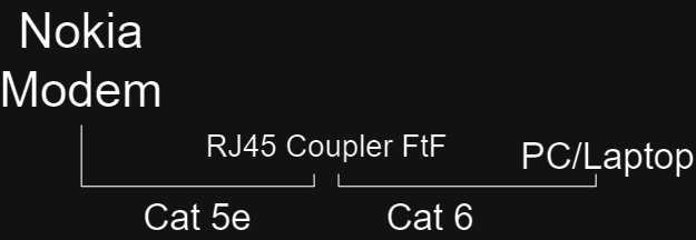

- BigNutBeanAspirant
Hello! I have checked my cables and ran them through a speed test and everything came out looking normal except when plugged into the R6400 Router as pictured below. I do not get my full speed.
_______________________________________________________________________________________________
When I ran the test as pictured below, I get my full internet speed.
I followed your instruction on checking the link speed and it shows 10/100mbps at the WAN Port. I unfortunately do not have another ethernet cable and will have to wait for another cable to arrive to test. What I don't understand is if I'm getting full speed connecting directly to the Modem, my cables should be fine and eliminated as the suspect?
Thank you!
- plemansGuru - Experienced User
some devices aren't as tolerant as others of sketcy connections. Routers tend to be less tolerant as if they mess up, the whole system messes up. Versus if a laptops connection is sketchy, its only effecting itself.
but it could be the router. That's always a chance. A bent/dirty, or bad port could be causing it. I'm not ruling that out.
