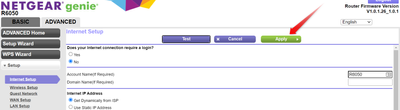

Hi all,
This issue has been happening for a few weeks.
Every 1-2 hours I get the "This site can't be reached" message due to DNS issues.
It also causes similar issues on all other network devices (both connected via LAN and wireless).
The temporary fix is easy, I just click the "Apply" button in the "Internet Setup" tab in the genie, and a few seconds later everything works again.
I've tried:
  • Rebooting the router and modem
  • Factory resetting the router
  • Changing the DNS address to Google's DNS servers
  • Turning off all anti-virus and firewall programs
Possibly useful info:
  • The issue rarely occurs overnight (but it does happen every once in a while) as I'm able to use all my devices for around an hour when I wake up.
  • I was away for 3 days and when I remotely checked my smart thermostat a few times it was working.
  • I'm using the most recent firmware version: V1.0.1.26_1.0.1
  • I'm using a Netgear cable modem CM700
Any help would be greatly appreciated. Thanks!

      plemans michaelkenward Thanks!
      Apparently, the R6050 doesn't have the option to switch to IPV6 (I looked & researched it)
      Additionally, my internet speed is 100/10mbps.
      Any other suggestions?
