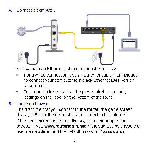

       Before you do the reset, you might want to read the User Manual.
    Especially the part where it explains how to configure the router.  I
    quote (page 14):
          2. Make sure that your computer or wireless device is connected to
             the router with an Ethernet cable (wired) or wirelessly with
             the preset security settings listed on the bottom label.
       Visit http://netgear.com/support (while you still can), put in your
    model number, and look for Documentation.

      Thanks for the link. The manual clearly says I can set the network up via WIFI connection.
