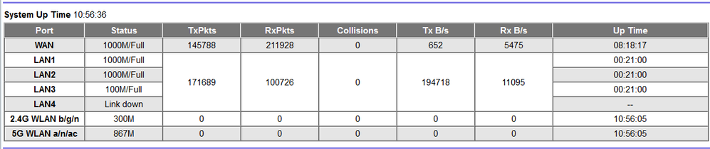

    Does wifi drop as well?

      Thank you for replying. The modem is a Fios ONT device supplied by Verizon (I think a Nokia 211). The wifi is not affected by the problem, or at least I have not noticed it ever happen.

      I'm including a screenshot of the router statistics. It looks like the last drop happened 21 minutes ago, but the wifi has stayed active.
