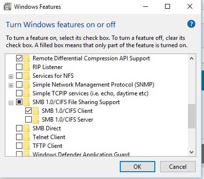

Okay, so I went into "add / remove programs" and I made sure the SMB 1.0 client is turned on:
I had to reboot and after I did, I pulled up Windows Explorer and typed "\\readyshare" but it did not see this device.

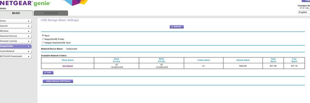

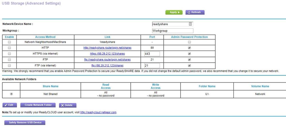

Logging into the router through routerlogin.net, here is what I see:
If I click on "edit' I see this view:

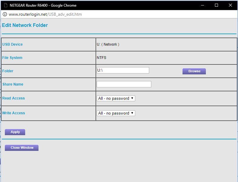

clicking "edit" I get this window:
If I hit "apply" it says "share name cannot be NULL" so I typed in "backupDrive"

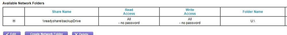

and then I see this:
but I still cannot see \\readyshare\... anything from Windows Explorer.

Again, as I said before: NetBIOS discovery and name resolution is packed with the CIFS/SMB 1.0 Server feature (what makes some sense, think about it!) since Win 10 18xx.
Instead of \\readshare you can use ie. \\192.168.1.1 (the router LAN IP).
