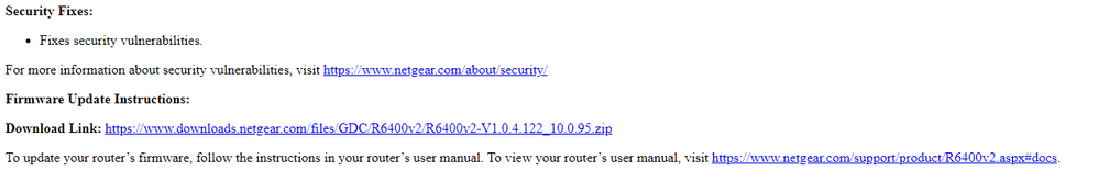

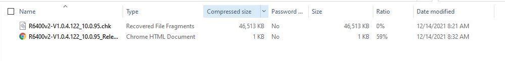

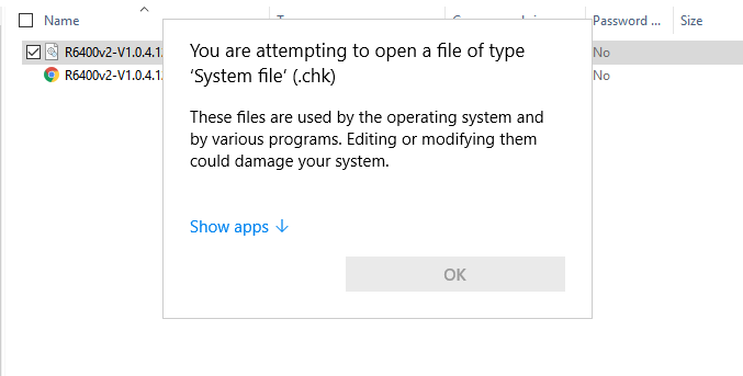

The "download" for the firmware on the website gives me a document that my computer doesn't trust, and an html link that sends me back to the same download link that gives me the same zip file...

when you download the file, it'll be in a zip file that you then extract.
After extracted, you follow the manual update process.
What does that mean? In what way "does not trust"?
If you get the firmware from the Netgear site, it comes in a zip file with the firmware and release notes.
My firmware version is V.1.0.4.106 which is probably a few updates ago, but I think every time I try to update this is what happens, and I give up.
There have been three since then:
R6400v2 Firmware Version 1.0.4.122 | Answer | NETGEAR Support

You don't "open" the file. Once its extracted, you follow the manual update process and upload it to the router.
https://kb.netgear.com/23960/How-do-I-manually-update-the-firmware-on-my-NETGEAR-router
