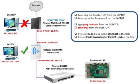

I just joined. This should be straight forward. I've tried both DMZ and Port Forwarding. This is all on my LAN. Just need to ping or ssh from the DESKTOP to the Raspberry Pi. Both ping and ssh work f...

> [...] If it matters this is an Orbi RBR50 mesh with one satellite.
And the RBR50 is connected to what?
> [...] The laptop is actually connected to the Orbi wirelessly, the
> DESKTOP is hardwired to the modem [...]
"the modem"? Are you offering any hints as to what that might be?
> [...] if this matters, from the Raspberry Pi, I can ping the modem
> (10.0.0.1).
It might matter, if I knew to what the Raspberry Pi is connected, and
how?

- DaveBrillhartJan 09, 2021Aspirant
Thanks bud! Agree that the two router and double NAT is problematic.
Just quickly.... the cable modem/router is on-perm (in my home) ISP equip, they are hard coded to the 10 net, and have limited access to features (it seemed). I have my own Wi-Fi Router - a mesh network, that distributes 192 addresses to dozens of clients. So, yeah, tunneling thru TWO routers was/is the issue I think.
I now think there is a way to turn off the cable modem's router personality and make it simply a modem. Then my Orbi mesh router will be presented with the Internet IP and I'll have a single device to punch a hole thru for ssh access to my Pi. With more features to setup a DMZ or Port Triggering or Port Forwarding... whatever make sense.
Thanks again!
