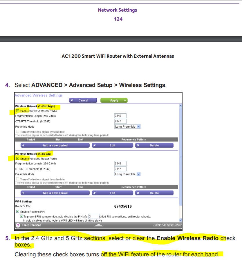

Does anyone know if I can set the R6220 dual band router to 2.4 GHZ only?  I have a Google Mesh System at the moment and I need a separate network using 2.4 GHZ only and google will not allow that.  I'm trying to set up a Ambient Weather STation  and it will only work on a 2.4 GHZ network.

       People who have read the R6220 User Manual should know.
       Visit http://netgear.com/support , put in your model number, and look
    for Documentation.  Get the User Manual.  Read.  Look for "Control the
    Wireless Radios".

    Yes, you can. NETGEAR AC1200 Smart WiFi Router with External Antennas Model R6220 User Manual, p.125 ... just untick the 5 GHz Enable Wireless Radio, and [Apply].

        > It[']s unfortunate that you decided to answer this thread in the way
        > that you have. [...]
           From the first reply:
        > [...] Get the User Manual.  Read.  Look for "Control the Wireless
        > Radios".
           Did you?  I'll admit that I was too lazy to post an annotated picture
        of the referenced page.  I'm accustomed to dealing with grown-ups who
        can read a book by themselves.  Sorry.
