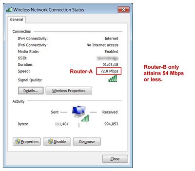

I have two identical WNR2000v5 routers, both have an identical config file loaded (which has the access point turn on, SSID name change etc.), both have the most recent firmware (V1.0.0.74), both are being tested with a laptop about 10 ft. away (only one router turned on at a time). Router-A's connection between the laptop and the router is consistently at 72.0 Mbps, but the second router, Router-B (not pictured), can't seem to do any better than 54.0 Mbps, and sometimes slightly worse than that.
Is this just some anomaly that is to be expected between identical routers? I can't think of any setting I can adjust given they are using identical config files and firmware.
It's a weird one but any suggestions would be appreciated.

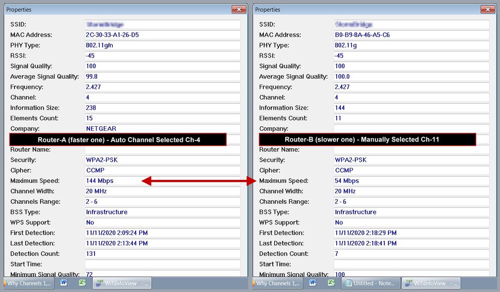

  • > [...] I can't think of any setting I can adjust given they are using
       I can.  If they're set to "Auto", then the radio channels could (and
    probably should) be different.  BASIC > Wireless : Channel.  Different
    radio channel, (potentially) different interference or propagation
    characteristics.
       A client device should be able to tell you which radio channel it's
    using.
       If you swap the hardware (and control for the radio channel), does
    the problem stick to the hardware or the environment?  You could try
    manually setting the channel(s), too.

      Wow! Thanks Antinode, I definitely wouldn't have caught that auto channel feature. Using a little utility called 'Wifi Info View' I was able to see that both routers were choosing Ch-4 in Auto Mode. I'm only showing the faster router on Ch-4 below and then I manually change the channel to 11 on Router-B (slower router). Also tried Ch-6.
      I'm still not all together clear on why I'm seeing the Maximum Speed difference - where the red arrow is (that assumes Ch's 6 & 11 might be better). So Router-B was about the same using the Auto Channel 4 and manually setting it to 6 & 11 (my router goes to 11) :smileyvery-happy:
      Some other oddities too (like the wifi type-PHY Type 802.11g/n vs 801.11g only - also auto feature?) and weird that the faster router seems to have a slightly lower signal quality and a higher Detection Count, which I'll have to school myself on.

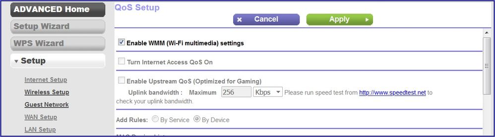

        Huh, in another topic thread, someone mentioned checking the WMM to on. Not sure why this worked when I have the same config file, but it did enable both 802.11b 'and' g which has correct the speed for the connection to the second router.
        Thanks again Antinode, it would have taken a LOT of time stumbling around had I not started at the channel issue.
