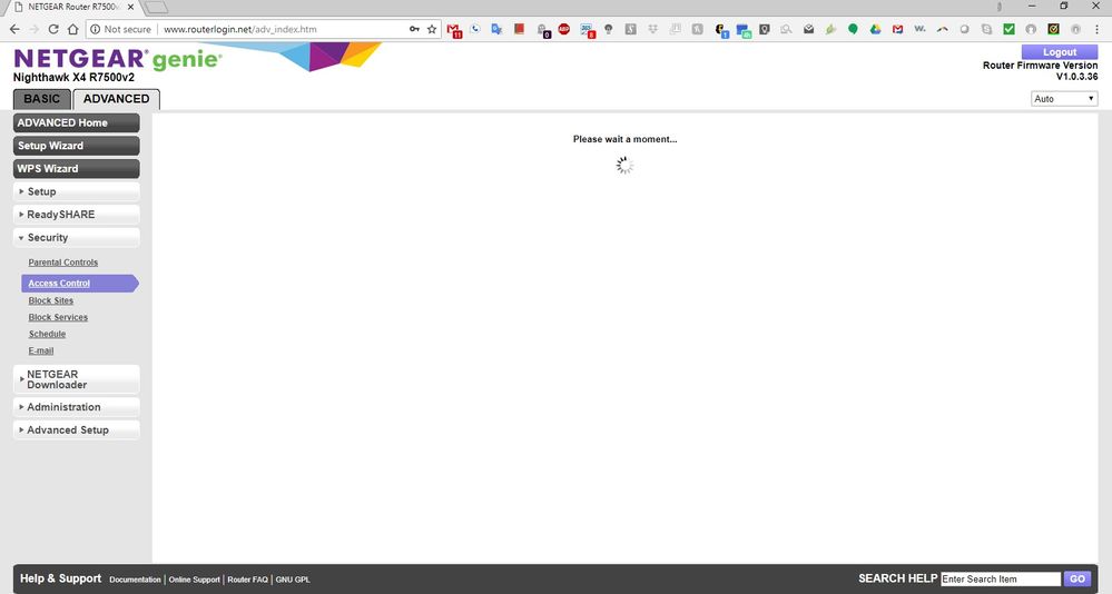

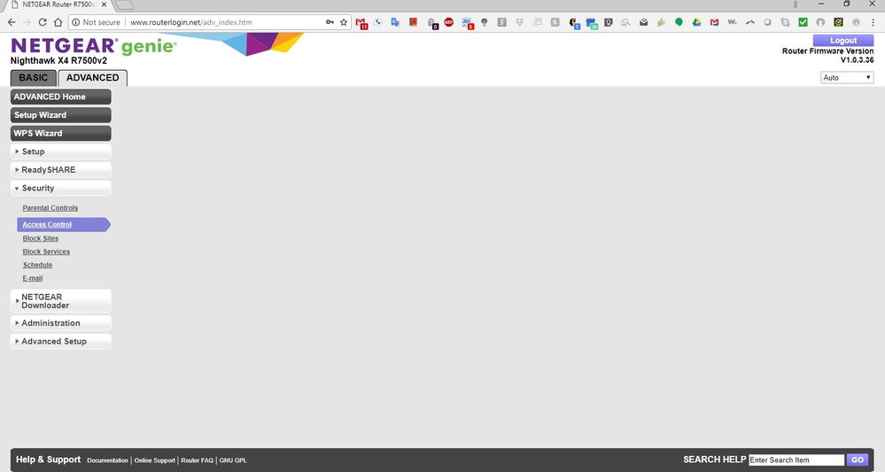

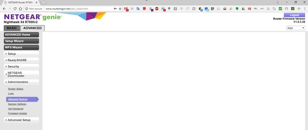

Recently I have been trying to access "Access Control" and "Attached Devices" from any browser when logging in to routerlogin.net. I can access all other tabs and links in routerlogin.net, but for some reason I can no longer see attached devices nor can I open access control. When I click those links it says, "Please wait a moment" with a cycling circle and then instead of bringing up the page it stays white with my tabs on the left hand side remaining. I can be in either the basic or advanced tab and I get the same results.
I have the latest firmware version already. I'm using Windows X OS and trying with Chrome, Firefox, and IE.
trying to access access controlresult after trying to access the access controlblank page after trying to see attached devices
