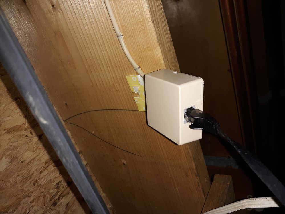

      I really don't know much about how the router works, or much about the subject in general. Where do I find what firmware version I'm using? I apologize for my lack of general knowledge on the subject. The extent of my knowledge when it comes to a Double NAT type is that the internet is being processed by two routers. However, we only have one router, and if there is a modem, I couldn't find it. The router is connected to a little box in the basement, but it had no markings whatsoever. I doubt this has anything to do with the problems I am having, but here is a picture of it.

        That answers the question. That little box almost certainly isn't also a router.
        Perhaps I should have asked what sort of internet you get. Cable and DSL need modems, and these sometimes also masquerade as routers.
        Optical, for example, just has a terminal of some sort.
