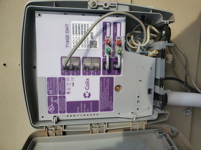

        Here is a picture of where the cat5 comes into the house. no modem in house bu, this is powered by a batteryback up inside our house
        exthousecable that comes from the exterior box on the house goes directly to router.
