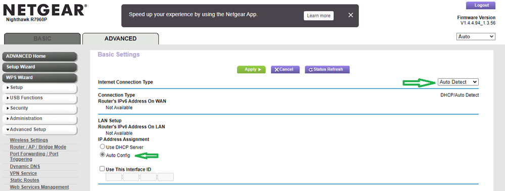

Enable IPv6 Auto if you continue to see DNS Probe or Proxy messages in browsers.

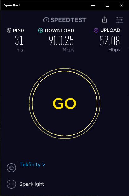

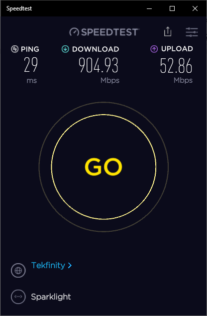

      Just loaded v.160 on my R8500 thats now connected to my CM1200 cable modem. Factory reset and setup from scratch.
      Will monitor for DNS issues. IPv6 is NOT enabled currently.
      Speeds are good though:
      Default settings, No Armor, Circle or Traffic Meter enabled:

        I've not seen any issues with DNS if users set IPv6 to AUTO or configure a IPv6 DNS configuration on the router, i.e. Hurricane Electric IPv6 services.
