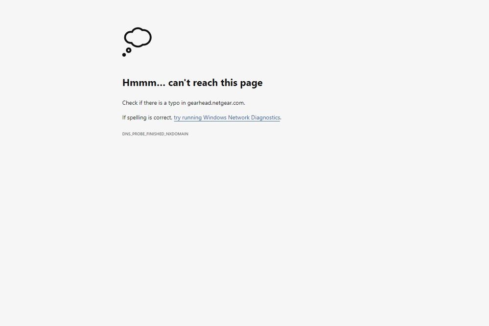

After upgrading to the latest firmware release two days ago, I try to go to any websites that I haven't been to before or haven't been to in a long time like "gearhead.netgear.com", I have to refresh the page multiple times in order to view the  page.
Websites like CNN.com or Amazon.com will work fine, it just the websites that are new or haven't been to in a long time will not load the first time. It happens with any browser or any device in my household.
When I try to go to the gearhead.netgear.com page, I get the following page displayed.

      My NG is connected to Xfinity PN/CGM414X Modem/Router. I have had this Modem/Router for years without any problem. The only thing that changed in my system was updated NG firmware.
      Is there a way to move the firmware back to the old version?

        A couple things.
        1. you can downgrade the firmware. You download it from the support site, extract it, and then follow the manual update process but use the older firmware.
        2. Your gateway is a modem/router combo device. It causes a double nat which can sometimes cause issues.
        A double nat happens when you cascade more than 1 router.
        https://kb.netgear.com/30186/What-is-Double-NAT
        Fixes? There’s 3 options but only use 1.
        1. Put the modem/gateway in modem only/pass through mode. This disables its routing functions.
        2. Leave the modem/gateway in router mode but put the Netgears IP address into its DMZ. This forwards the data to the netgear. You can either leave the modem/gateway’s wireless enabled or disabled. Just make sure its using a different wifi channel to prevent interference
        3. Put the Netgear into access point mode. This disables its routing functions. Wifi/ethernet still works but it does disable some features.
        https://kb.netgear.com/26765/Which-features-are-disabled-on-my-NETGEAR-router-when-it-is-set-to-AP-Mode

    what firmware version are you on?
    Is IPv6 enabled? (try enabling it if not)

      I'm on firmware version V1.0.4.76_10.1.82.
      1) I guess I'm not connected to IPv6. See below:
      2) Do I need IPv 6? I didn't need IPv6 before firmware upgrade.
      Do I Need IPv6? I didn't need IPv6 before firmware upgrade.

        I'd try enabling it. It then has the router use the ISP's IPv6 dns server and that can sometimes help.
        If it doesn't, then try the downgrade.
