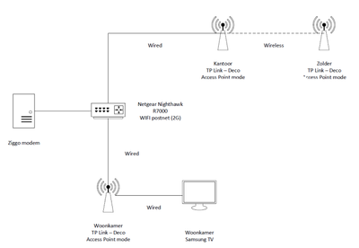

Dear community,
We are experiencing a drop in internet connection at least once a day. I can not find the reason why this drop is happening. The only thing that helps is resetting the R7000. After a reset, it works like a charm, with download speeds up to 300mb/s. Therefore, I am seeking the support of the community.
This is the setup:
1. A modem from the ISP is set in bridge mode (DHCP turned off) and is the entry point of the internet
2. The ISP modem is connected with a wire with the Netgear Nighthawk R7000 set in router mode. WIFI is turned off
3. Two TP-Link Decos (DHCP turned off) are connected with a wire and set as an access point. One goes to the living room on the same floor, and the second one goes to the first floor.
4. Another TP-Link Deco (DHCP turned off) is set on the addict and wireless connected with the TP-Link Deco on the first floor.
It does not look like the drop in connection is caused by the ISP. Any tips or suggestions would be highly appreciated.
Thank you very much!

      Surprisingly, all devices lose connection at the same time. Maybe it is a coincidence, but it happened two times between 6-7 am. Remember that the only wired Ethernet devices are just the APs extending the WIFI.
      So basically, I am using the Nighthawk to act as a router and DHCP server that provides the IP addresses to the network. This includes the APs. I was told to turn off DHCP on the modem and the APs; otherwise, this could lead to an IP collision.
      Modem = bridge mode
      Nighthawk = router mode
      APs = access point mode
      Let me know if this helps. Let me know if you need any more info that can help me push me in the right direction.

        Does the WiFi signal drop out on the devices when the internet is lost or are the devices still associated with the APs but cannot route out to the web? So the WiFi is solid but internet is intermittent or both intermittent?
        Im still wondering if there's an ip conflict between the router or AP and a device that wakes up from time to time.
        I wouldn't rule out a dodgy Ethernet patch cable or Cat5/6 wall socket. I had a dodgy wall socket that made my router drop out intermittently and it took ages to discover.

    This is the setup:
    What is this ISP modem?
    "DHCP turned off" is not the same as bridge mode.

      The ISP is the modem from my Internet Service Provider. So basically, where the internet comes in.
      The modem is a router at the same time. But I do not want to use the router functionalities from this modem due to poor performance. Therefore, the service provider offers to set the modem in bridge mode. Bridge mode with this service provider means that the DHCP server is turned off automatically. Please see below a URL in Dutch from the service provider.
      https://www.ziggo.nl/klantenservice/internet-wifi/bridge-modus
      I hope this clarifies. I am looking forward to hearing some suggestions that I can have a closer look at. Thanks!
