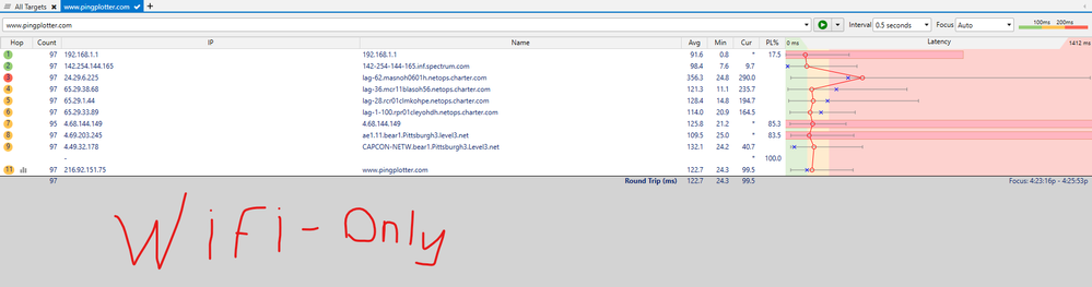

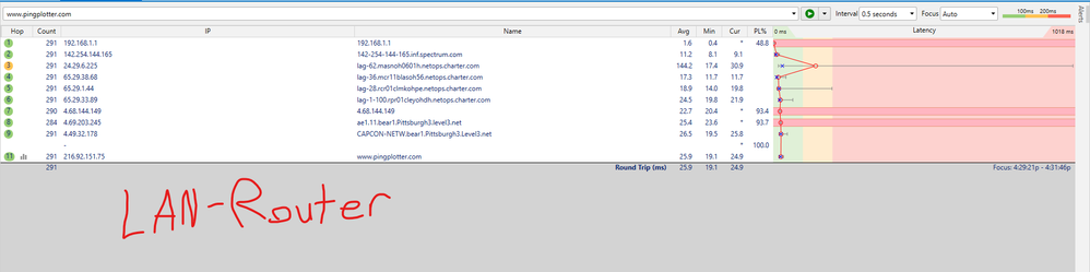

I use wireless connection, but there's no major drop-off between hardwired and wireless (as shown in attached images). Wire is CAT5E, but might make a purchase for CAT6 or higher soon.
I ran pingplotter and these are the results:
As you can see by the results, there isn't too much variation. But, it looks like the connection gets severely hung up at one of the netops.charter.com locations. Not sure what to do with this information, so I'm hoping you could assist me at least a little bit. I think this is a mix of issues between the router and the servers in my area.
