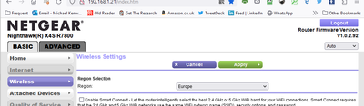

    What do you see in the settings here:
    • Basic
    • Wireless
    • Region Selection

      • Region Selection - EUROPE
      • although both ENABLE SMART CONNECT and ENABLE SSID BROADCAST is not ticked.
