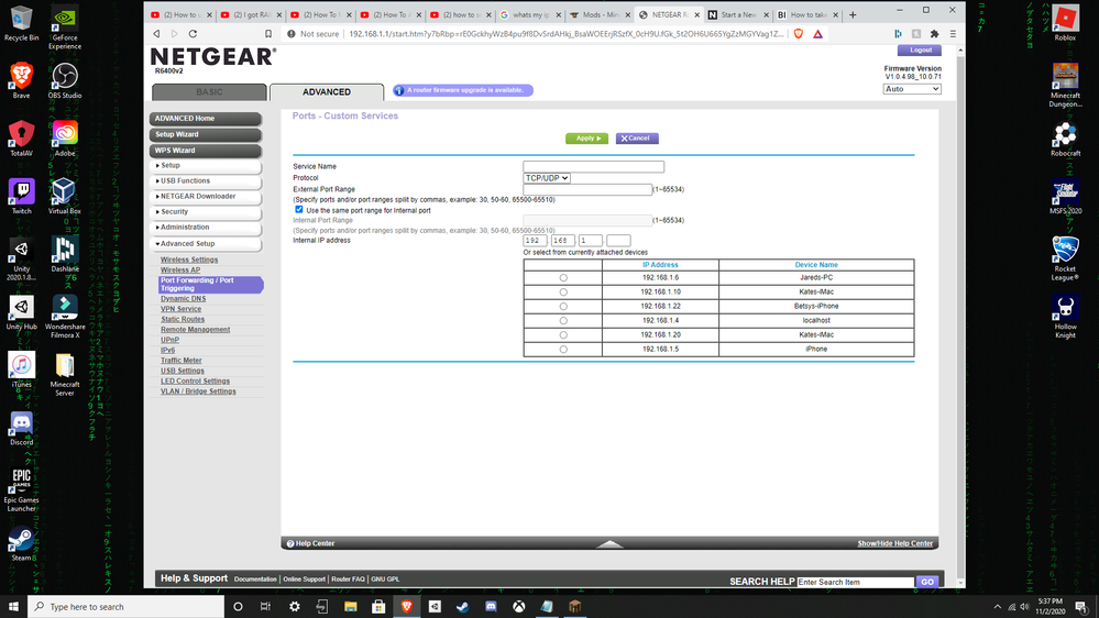

so today I was setting up a minecraft server and when i proceeded to port forward it i got this, down below. there is no way to change the external starting point or ending point and no way to set internal ones either, please help!

I don't have this particular router, but I haven't had trouble with port forwarding on a wide range of Netgear routers.
The only field that appears grayed out is the internal port range, and that is simply because you checked the option to use external range internally.
What exactly can't you set? Have you entered something in the Service Name field?
What port(s) are you trying to forward?
