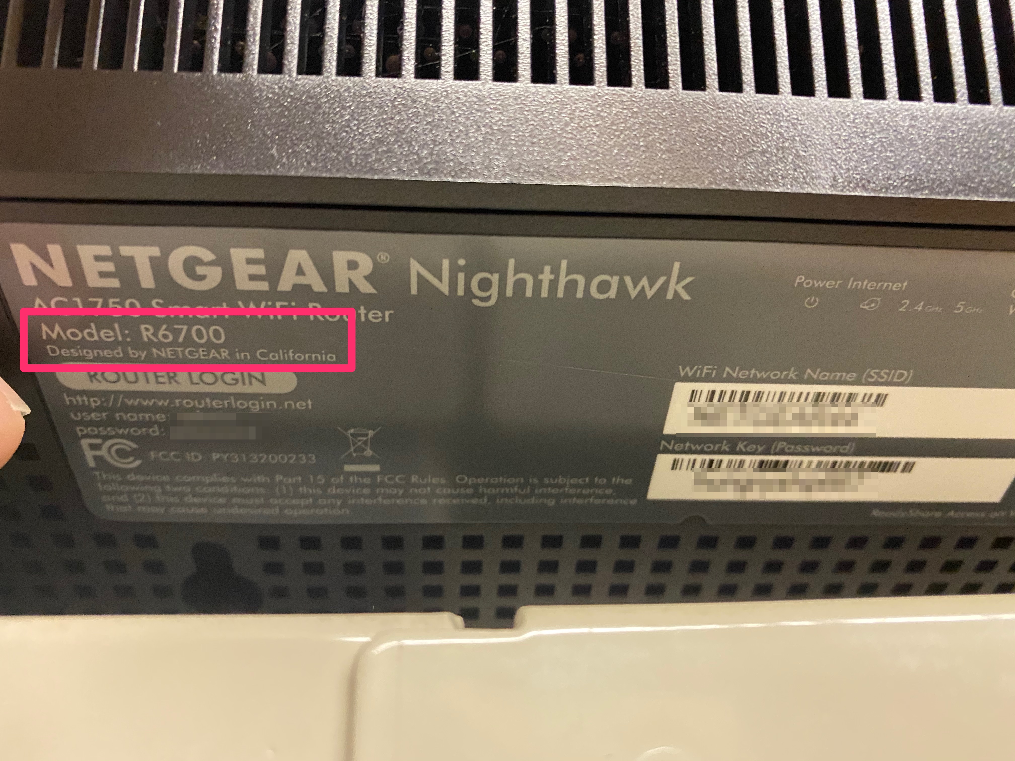

      antinode wrote:
      > I have verified that my R6700 router is not the V2 or V3 models [...]
         "verified" _how_, exactly?  Look for "Model" on the product label?
      What is its current firmware version?
      I confirmed it by looking at the model number sticker on the botton of the router (see attached screenshot) and on the Admin page when logged in. The current firmware version installed is V1.0.2.8_10.0.53
