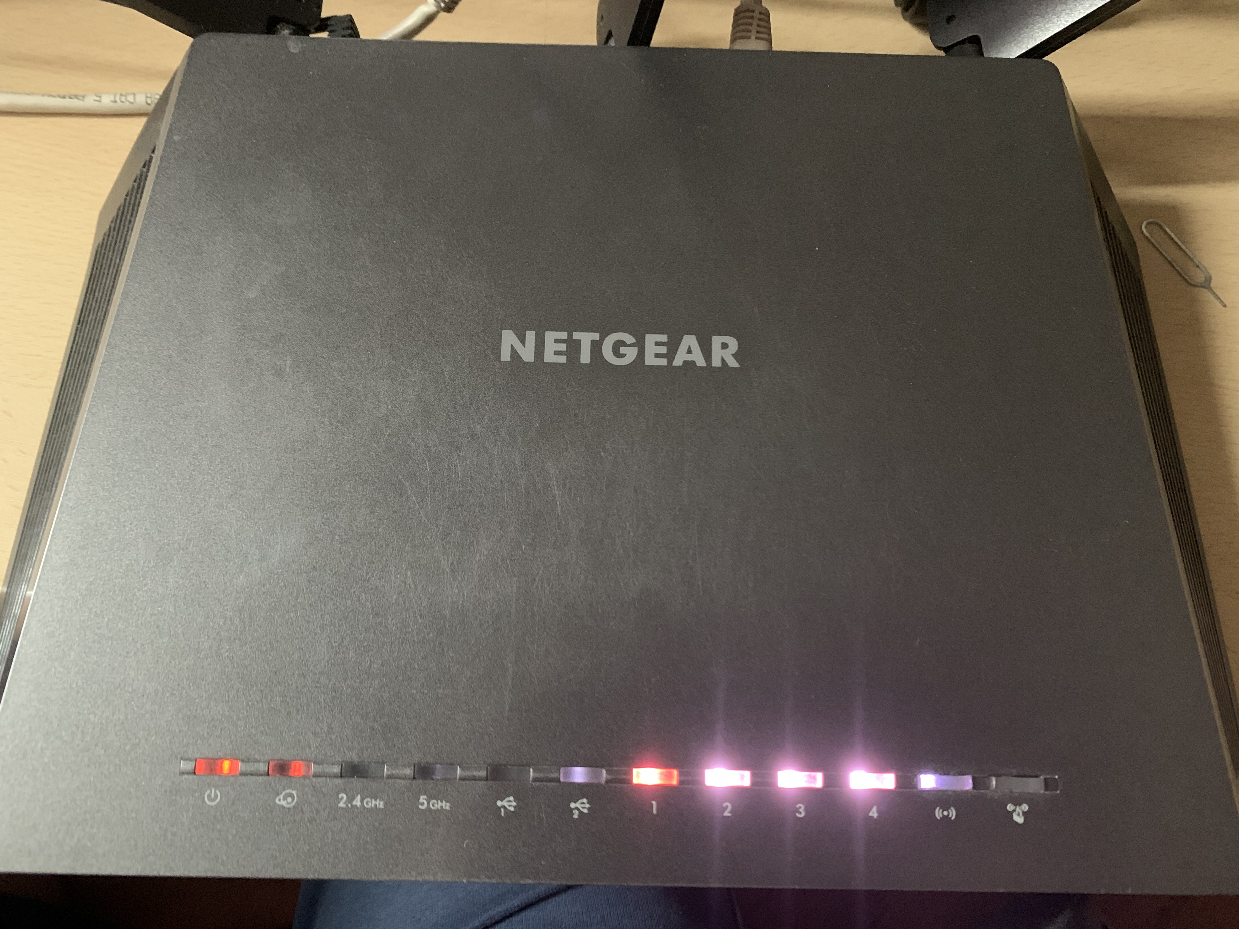

R7000 not starting
One day I wanted to set my R7000 as acess point, so I reset the R7000. But I accidentally pressed the reset button while the router started just one second. Now the R7000 won't boot and everytime when I started the router, it stays at the status which the power led, the internet led, port 1 led are in dim orange light, ports 2, 3, 4 leds are in light orange led. On the other hand, the wifi led and usb port 2 (I haven't connected anything to the router) are in white led. I have tried all solutions metioned online (tftp/30-30-30), all are useless.
***This R7000 router was bought at the time it was introduced to the public.

    • ghost_hand's avatar
      ghost_hand
      Thanks for your suggestions. However, I think that my R7000 is bricked and I have tried all the methods even with the nmrpflash and the tftp, it still doesn't unbrick.

  • michaelkenward's avatar
    michaelkenward
    The power LED is not white?
      ghost_hand
      Yes, everytime when I power on the R7000, the power led is dim orange.
