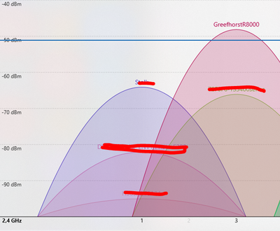

I experience a lot of troubles with my R8000 router. Devices lossing connection; the router often does nt show all connected devices (some device that are working properly are not listed), mostly one the 2.4Ghz band.

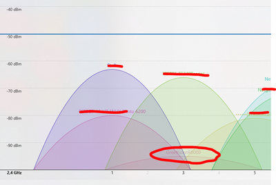

When I look at a wifi analyzer I can see a string signal for my network GreefhorstR8000 but when I keep looking at it, at least one time per minute I can see the signal string dropping to very low. The router was in the same room at 14 ft distance.
I allready performed a factory reset, but that did not resolved the problems.
I have about 25 devices connected, among them 5 IP-cams and 4 chromecasts. I expect that the R8000 should be strong enough to handle those.
Does anyone has an idee of what can cause these drops in signal strength?
