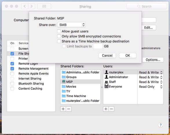

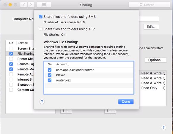

I have a user account called "routerplex" and I have enabled the user account. Please see my settings below. Do you see any issues with them?
Thanks again!
