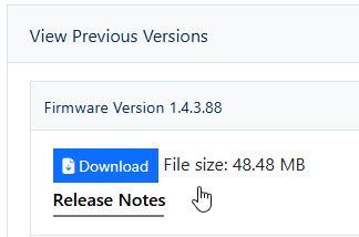

      Here are the steps that I followed to find previous versions of the firmware:
      1. Go to Netgear.com.
      2. In the top menu bar, click Support.
      3. Enter your model number (R8000P) where it says "Welcome to Netgear Support".
      4. The next page shows your model number and a nice picture of your router. Below that, click on Downloads (or simply scroll down a little bit).
      5. You'll see a label that says Current Versions. Six lines below that, you should see a label/link, that says View Previous Versions. Click on that.
      6. Each of the previous versions should have Download link. Download the versions you need.
      7. To manually upload the firmware to your router, follow the instruction on page 74 of the Netgear Nighthawk R8000P User Manual.
      Manually uploading the firmware to the router is fairly straightforward.
      Although, many people, including myself, have had lot's of trouble trying to update the router beyond v1.4.1.50_1.3.10. My particular problem was only solved after I convinced Netgear to send me a "new" router (they actually sent me a refurb router - which is consistent with the Netgear warranty/service terms and conditions).
