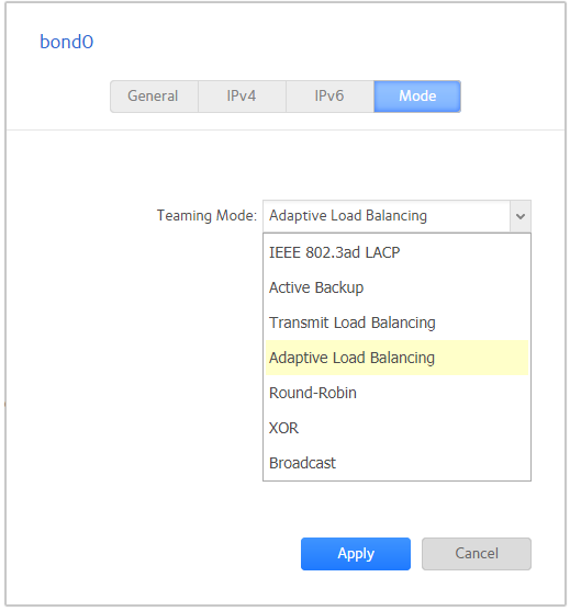

I have bought a S8000, because the switch is able to manage the link aggregation (announced in product description) but I'm not sure if the S8000 can support the LACP 802.3ad mode, I have connected my ReadyNas RN312 in mode LACP with layer 2+3, and I can't reach my NAS in this mode. I'm not able to check in which mode the S8000 is working when the Link Aggregation :-(

Ok, thanks, which teaming mode can I use on my ReadyNAS to get the best data speed performance with th switch S8000 ?
