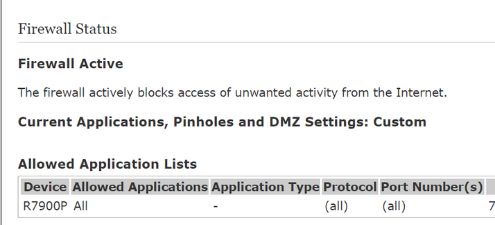

      #1 isn't an option with AT&T so I attempted #2.
      I have set a DMZ on the AT&T router with the router as the permissible device.  After a reboot of both routers, it works great for a little while.
      And then it starts behaving in the same way.  I don't want to move to option #3 as I really prefer managing everything through Netgear.  Plus I use my guest wifi for my company provided equipment and I will lose the guest wi-fi if I go Lan-to-Lan.
