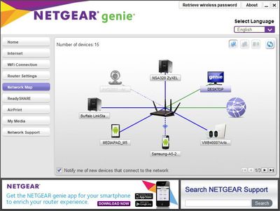

You need to track down the IP address of your R7800. There are a few ways to go about it.
- Check the IP address in the list of attached devices in your router
- Check the IP address of the WiFi from the R7800
- Use network map in the desktop genie for your operating system
All of these will give you an IP address that you can put into a browser. I use the genie because it does other useful stuff.
The genie will even throw up a clickable link to the R7800.
Netgear is trying to kill this useful utility, but for the time being you can find it here:
genie | Product | Support | NETGEAR
Be warned that the genie installation file is wrapped up in a RAR archive that you have to decompress.
