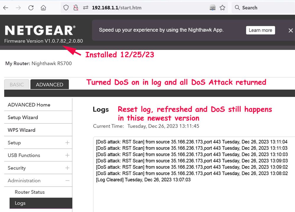

  • Unfortunately, this firmware still has the issue with the false positive DoS attacks filling up the logs. Will hang on to the old firmware until this gets fixed.

      What happens if you disable the logging feature for DDoS attackes while v.82 FW is loaded?
      Also how was the FW updated and did you continue to use the router after FW was applied, powered OFF the router for 1 minute then back ON or had a factory reset been performed afterwards then setup from scratch?

        Even when I had logging for DoS attacks disabled, it would still take up resources. Only reason I noticed this was because I noticed that the router was slowing down/crashed by the end of the week. Also, if you turned logging back on, all the previous false positive DoS attack logs would appear right away and crash access to the log itself due to so many entries appearing there.
  •  installed and rebooted router yesterday 12/25/23 Monday
    Turned back on in logs for logging Dos Attacks and again with this newest version still occurs
    Just cleared log and DoS frames entering router

      And if you disabling logging, do you still see DDoS log enteries or no?
      If you disable the logging for DDoS, do you notice any router mis-behaviors with logging disabled?
      Also that IP address shows it's from Amazon:
      Organization: Amazon Technologies Inc. (AT-88-Z)
      RegDate: 2016-08-09
      Updated: 2016-08-09
      Ref: https://rdap.arin.net/registry/ip/35.152.0.0
