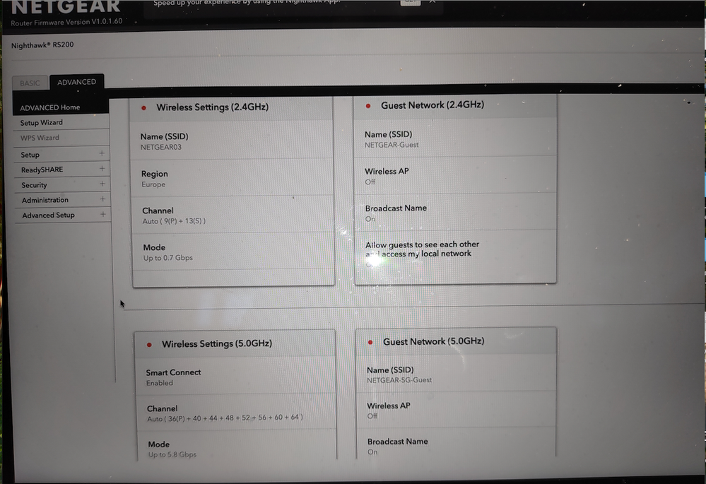

Nighthawk Rs200 - no WIFI after Reboot - Internet via LAN ok
Hi all
the problem is at a Nighthawk RS200 - The configuration iwth my provider here in Luxembourg worked fine. VLAN TAG - is used here for orange.lu
now.... some fine tuning has been done and i clicked the restart button in the router dashboard.
NO WLAN anymore. On the router itself - all LED s are correct in white and showing activity. But on the dashboard the WIFI have a red indicator. several restarts were unsuccessful. no WLAN anymore. even a switch on/off was not helpful. A complete reset and reconfiguartion of the RS200 solved the issue.
Hardware/firmware info see underneath the screenshot
Hardware VersionRS200
Firmware VersionV1.0.1.60
GUI Language VersionV1.0.0.449

    After a 2-hour phone call with the English-speaking support team, the problem disappeared (although this was probably a coincidence after a factory reset). The router probably assigned the IPs randomly so that there was no longer a conflict. As I have now been able to find out, it was most likely an IP conflict in the WLAN as both static and dynamic IPs are assigned in my network. However, the DHCP assignment referred to the entire address range. This most likely led to the said conflict - which then “deactivated” the WLAN - this also happened to me with competitor products. Furthermore, there was another 2 router in the network which was also configured as a router instead of an AP - but with DHCP..... switched off.
