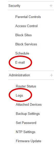

I've been practically all over the Advanced Tab and subsections and cannot find where to set this up. The Help section in the Logs subsection does state "Click Send Log to send the log file to your e-mail account" BUT, there is no Send Log button anywhere.

  • Hello Dummy001​ (no, you are absolutley not - far to many users never look into the online documentation)
    Not a Nightawk RS router owner or user here. Have looked over the RS100 User Manual - and have not spotted any indications of this feature.
    Looking a little bit further on "bigger" models User Manuals, like the
    https://www.downloads.netgear.com/files/GDC/RS200/RS200_RS150_UM_EN.pdf , starting from p.65 one can find a this section:
    Set up security event email notifications
    The router can email you its logs of router activity. The log records router activity and security events such as attempts to access blocked sites or services. To set up email notifications:
    ADVANCED>Security >E-mail. The E-mail page displays.
    The https://www.downloads.netgear.com/files/GDC/RS90/RS100-90-70_UM_EN.pdf does not show this feature, so best guess is: This feature is not available on the RS100,
    Looks to me this section on the device online help does not completely removed for these "smaller" models for simplicity.
    In case you are a "new" to the RS100, and you own the RS100 for less than three months - you are entitled for 90 days of complimentary technical support for the installation of your Nighthawk RS100 router, which begins from the date of purchase (== the product registration date) - contact Netgear Support via https://my.netgear.com/ and ask if this impression is correct.

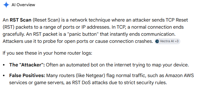

  • My old router was a R6220. The new one is a RS100. When reviewing the logs just today on the RS100 I see an ABUNDANCE (I use the capitals to emphasize this) of various DoS Attacks. The R6220 would show just basic DoS attacks but the RS100 is showing stuff I've never seen before. i'll attach my log for reference.
    So, what's going on here. I've NEVER had this many attacks, ever.
