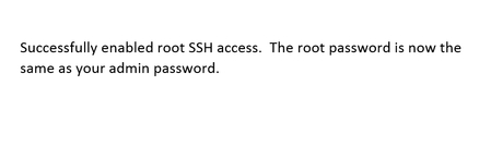

Hi Took advantage of the long UK Bank Holiday weekend to try and fix my earlier issue Solved: The client and server don't support a common SSL p... - NETGEAR Communities I loaded old Firefox onto a...

Did you reboot after enabling ssh?
- yes from admin page shutdown and reboot

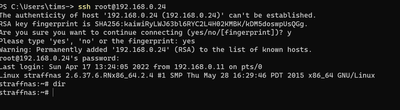

straff wrote:One thing you could try is attempting to use ssh to connect to the NAS - is that something you've used before?
- no, is it simple (?!)
Just connecting isn't that difficult.
You'd enter ssh root@nas-ip-address from the windows search bar (or from terminal if you are a mac user). The PC will ask you about accepting the fingerprint (I forget the exact wording), which you need to do. Then you should see a password prompt. The NAS admin password should work (assuming it is not the default admin password).
- straffApr 17, 2022Aspirant
Re: ssh - I think it worked?
