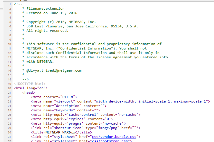

    Reconsidering you mentioned having updated the firmware, the Web UI was undoubted workable, not looking as empty as you stated before. Time to drop the browser cache probably, and force reload the page?
    Below, for your reference, is the beginning of the html code from any WAX6xx - indeed, this is the generic name before the standard JavaScript does rattle in, showing the effective product name:

      In your screenshot the key part of the web interface is just past the end of what you have shown.  There is a <div id="app"> tag where you will either see tags for the UI, or there will be no tags visible.  You might have to look in the DOM Inspector as depending on the browser, the 'view source' function may only show the original file before the code running on the page modified it.  In this case you'll see the <div> as empty.
