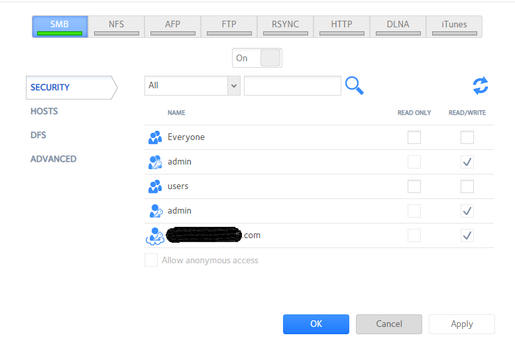

As I was trying to see if I could reset SMB access from the web GUI (and tried turning the service off and back on), I thought useful to relay the SMB settings under the Network Access settings for a sample share (which is same across all shares, except one; admin user and group have read/write access, no Hosts are filtered, DFS is not enabled and Advanced has SMB3 Enabled and Strict Sync checked.
