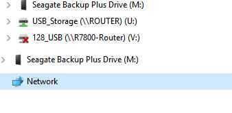

Can't see my Router in Windows Explorer
My Nighthawk was sharing files perfectly, but now I can't see the Router in Windows Explorer (Windows 10).
Has anyone else had this problem?
The "Network" prompt can't be expanded:
Curiously my mapped network drives work fine, and I can access the files on the router using the Genie iOS app.
But I can't address them with a SONOS or using the network address //Router/USB associated with the ReadyShare.
I have updated Firmware to the latest version, and Windows has latest updates installed.
Anyone have any ideas?

    Problem could be the CREDENTIAL MANAGER (on Control Panel). Since it is on the Router it probably needs a credential access the ROUTER (UID and PW). When you look at the Credential Manager for the Web tab you will see one for the router (or should). That is why on the PC you don't get prompted for UID and P/W.

  • When you run NET VIEW in a CMD prompt, do you get and error message or see ALL the PC's or other devices on the network?
    You may need SMB1 running. Check if it is in a CMD prompt with sc.exe query mrxsmb10 and it will show if it is running or not.
    Not running. Go to PROGRAM AND FEATURES and add it back in.
    • Jradders's avatar
      Jradders
      Hi IrvSp,
      I've added in SMB1 and I can now see the Router in Windoes Explorer.  Thanks.

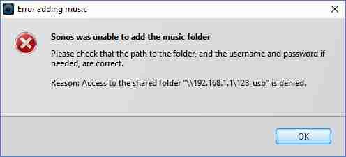

      Am now stuck between SONOS controller and accessing the Readyshare (USB with music on it).
      SONOS will add HDD directories, USB in PC but not ReadyShare (it used to work).
      Error is this:
      Problem is I can 't find any rights settings in Genie or 192.168.1.1 portal
      I don't have any passwords on Readyshare and am just running Basic.
      All suggestions welcome....
