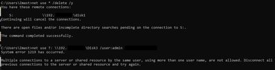

- Zmaster211Mar 19, 2021Aspirant
This is what i get.
- StephenBMar 19, 2021Guru - Experienced User
Try rebooting the PC and entering them again.
FWIW, you don't need to mask 192.168.x.x IP addresses. They are not routable over the internet, so they cannot be used to reach your NAS.
