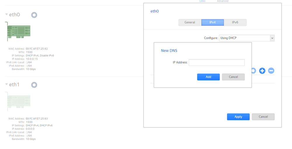

Do you have 8.8.8.8 in the DNS server list of the NAS?
- gus1234Jan 18, 2018Aspirant
No I dont have 8.8.8.8 in the list. Should I add it (how would I go about doing that?)
- gus1234Jan 19, 2018Aspirant
No luck unfortunatley still getting the same error
