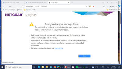

- larsgelnJun 28, 2024AspirantSpoiler
This is the answer in swedish. ReadyNAS detects no discs.
. Confirm that discs are installed.
. If discs are installed, swap the discs.
. Go to community.
Blue square i NEXT.- StephenBJun 28, 2024Guru - Experienced User
. If discs are installed, swap the discs.There are two main possibilities here:
- both disks have failed
- the sata backplane in the NAS isn't working (either a bad chassis or a power issue).
One path is to test the disks in a Windows PC using vendor tools (Seatools for Seagate, Western Digital for Dashboard). You can connect the disks either with SATA or a USB adapter/dock. Windows won't mount the disks, but the vendor tools should be able to find them.
- If they can't, then you are likely dealing with a double disk failure.
- If they can, then I recommend doing the full long diagnostic test on each of them.
Another path is to try a factory default with a spare disk (not in the array). If that works, it will be reformatted, so make sure there is nothing on it you care about.
- If that succeeds, then you are dealing with bad disks.
- If it fails, then likely it is a bad chassis/power issue.
