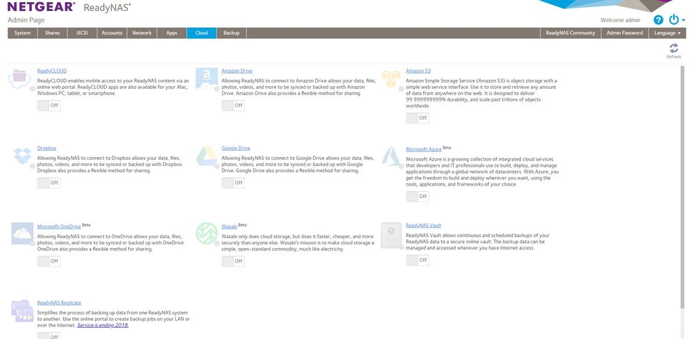

- Jake2Oct 31, 2018Aspirant
Hello,
Login to the Local Administration page then go to Cloud tab and click leave on the ReadyCloud Service - I would like to do this, but there is no options as shown in the image.
Thanks.
