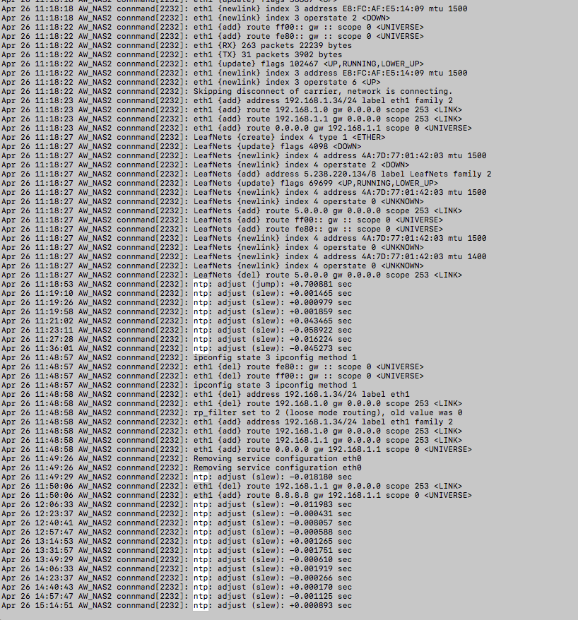

Connman.log pasted below. Also, I was able to upgrade f/w from the internet a week or two ago so it has access to Internet.
StephenB
Apr 26, 2018Guru - Experienced User
Are you adding routes? For instance, 8.8.8.8.
8.8.8.8 is a DNS server, the gateway should be your router's IP (192.168.1.1).

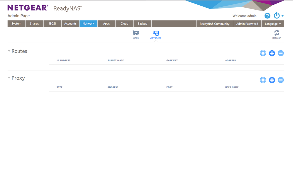

- bigawplanoApr 26, 2018Aspirant
Yes, I've added those DNS entries (see attached). I realized a few mins ago that my hostname had a "_" which is an invalid character. I changed it to a "-" but it made no difference to my problem.
And I do not have any routes specified. Should I?
- StephenBApr 27, 2018Guru - Experienced User
No. The IP setup looks correct.
