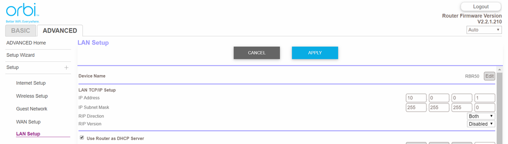

Look on the ADVANCED > Setup > LAN Setup page of the router. Note you are changing the addresses for all the devices on your network.
I use a different router (Orbi), but the screen should look similar to mine (below):
Mine happens to be set to 10.0.0.1; yours is probably 192.168.1.1. Reset it to 192.168.0.1.
Also check the "Use Router as DHCP Server" which should be right below the router IP address. When you change the router IP address, that range should also change to 192.168.0.2 -> 192.168.0.254. Since you are using 192.168.0.2 for the NAS, you also need to change the starting address. 192.168.0.100 will work fine for this.
After you regain access, I suggest resetting the NAS to use DHCP on the network settings tab. Then reserve an IP address for the NAS in the router (address reservation should also be on the ADVANCED > Setup > LAN Setup page).
