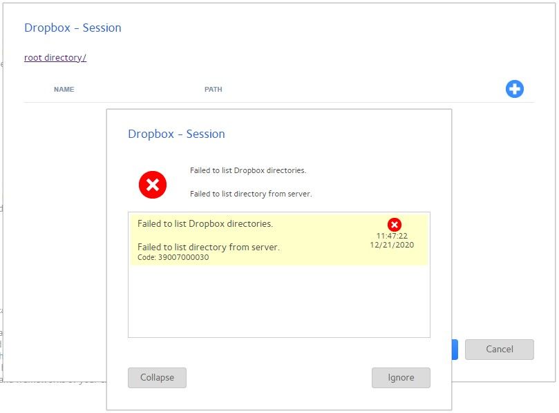

  • I noted only certain files/folders updating on my dropbox (all synchronisation complete) when editing / moving files and folders on my ReadyNAS 2304. Tried to re-setup the dropbox sync but the 'Cloud Storage Path' just returns an error - "failed to list dropbox directories" (see below screenshot).
    Anyone managed to solve this yet? I note the majority of these are from the tail end of this year, has something changed between ReadyNAs and Dropbox. I have tried different browsers, clearing cookies, restarting the NAS and spoken with Dropbox, and they have sent me over to ReadyNAS as they do not have an answer.
    Thanks!

      Contact Netgear support and ask to be transferred to Level 2.
      It took some time but they were able to resolve it for me. the issue was the number of directories and their system timed out. Try upgrading to the latest firmware, possibly the change that was done is already released.

  • Just an update.
    This was solved via a firmware update and a reboot.
