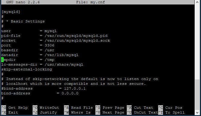

hi john , i am not that familar with linux but i did some digging and i was able to do the changes and even after restarting the mysql services, i was not able to connect, this is the snapshot of my config file , and when i try to query with
db = MySQLdb.connect(host="192.168.1.30", user="root", passwd="", db="rigatron_db", port=7082)
i get
_mysql_exceptions.OperationalError: (2013, "Lost connection to MySQL server at 'reading initial communication packet', system error: 0")- StephenBGuru - Experienced User
You are trying to connect on 7082, but it looks like the NAS is set up to use 3306.
Did you try connecting on port 3306?
