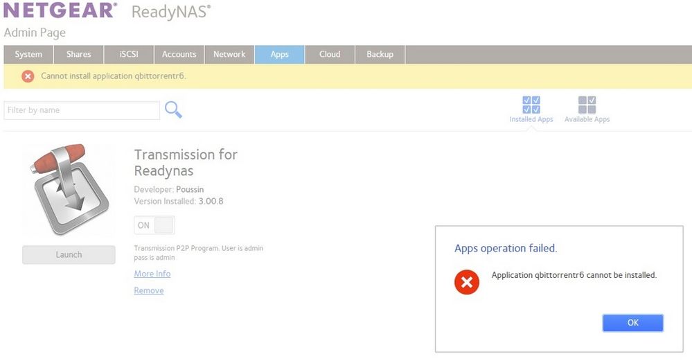

Нello, i have readinas pro 2 with firmware 6.10.9. I would like to apply this instruction on my readinas. Because I can't install uTorrent and some other apps. The problem is that I have never used S...

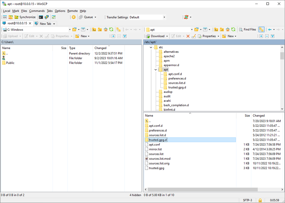

Start by enabling ssh in system->settings->services. Check the box next to password authentication.
Then when you access the NAS with ssh, use root as the account name. The password is the same as the NAS admin password.
Since you don't know the commands, I suggest you install winscp on a Windows PC instead. This is free.
When you launch it, you'll see a "login" screen. Click on new site, and then create a login using the SFTP protocol.
Click on save, and then use this login with winscp.
You can then navigate to the apt folder by selecting <root>, then etc, and then apt in the right pane of winscp.
Drag the two files Sandshark posted into that folder (apt.conf and the modified sources.list).
I generally rename files I modify to .orig, and also put a second copy of the modified file with a .mod extension. Then if Netgear updates the files later on in a firmware update, I can see what they've changed, and re-apply my mod.

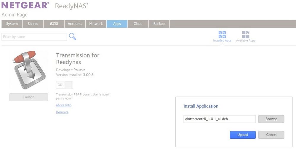

- PaniimSep 08, 2023Aspirant
Thank you very much for your detailed answer! I can download files in an Internet browser. And then download them locally to the NAS device. But the installation fails. Does this mean that the files are not suitable for my system?
- StephenBSep 08, 2023Guru - Experienced User
As I mentioned above, I don't have these apps installed, so !'m not the best person to give you troubleshooting advice on a specific app. But I just tried to install this one on an RN102 I use for testing, and it did install. Removal also worked properly.
Did you follow the instructions on how to add Sandshark's two files onto your NAS? If you did follow them (and see the files in the apt folder), then try rebooting the NAS.
Note that while I keep both the original and modified files in the folder for convenience later on, the one that is used by the NAS is sources.list. So that has to be the modified version,
- PaniimSep 09, 2023Aspirant
StephenB wrote:Did you follow the instructions on how to add Sandshark's two files onto your NAS? If you did follow them (and see the files in the apt folder), then try rebooting the NAS.
Yes, I followed these recommendations. But some applications cannot be installed. My system is based on Intel Atom. She's very barn. This is probably an application incompatibility with my system.
- mathiouroseNov 13, 2023Aspirant
Hi - Thanks very much for the detailed process - I got all the way through (readynas rn316) dragged and dropped the two files (apt.conf and sources.list) into /etc/apt/trusted.gpg.d/ and rebooted. Still wont install apps (eg iDrive).
Please advise what I might be missing?
Thanks again.
J Rose
- SandsharkNov 13, 2023Sensei
You still have to do the apt-get update (note NOT upgrade) command from SSH.
