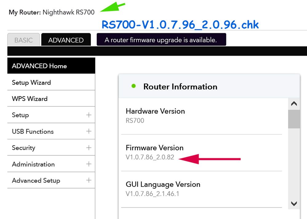

Hi Folks I have a RS700 Netgear update problem I hope you can solve wih a fix
Router is set as you see in this screenprint to do auto upgrades but it never does.
So I went on Netgear website and downloaded the newest version
you see I listed in blue.
Old .82 new .96
As you see it is newer than what the router is using
Since even when I tell the router to do a update via Netgear once that process is over and I check it still is using the older version
BTW when process is over as norm my browser shows loss connection to the router and call up that URL again and it than works so clearly something in the update process is doing something
I than do a manual upgrade selecting on my P/C this newer version and the process starts but again when done the router still shows using the older version
Why is this happening and how do I correct this so newer version is now functional on RS700 ?
Tech Support says support ended for my unit 3 1/2 months ago so will not even help as their own updates fail 😞
Thanks for any help.. .JR
Old .82 new .96
The Firefox browser is not the issue as the router is set to do upgrades automatic
and even installed the Nighthawk App on cellphone and selecting upgrade be done than says succesful yet looking at the RS700 still shows the older version still being used.
Also the router still says an upgrade is needed

The RS700 I got last year the first thing had to do was a firmware upgrade which was .82
The few newer upgrades and the last .96 even though the upgrade process when done stated sucessful the router still showed version .82
I tried doing this via setting router to auto, I did it manually via browesr and even installed their Nighthawk App on cellphone ( which beagn spamming me so uninstalled but upgrades failed that process to

Update as of Weds, 3/26/25
After much hassle, 4 different Netgear case numbers assigned by them, over 20 emails
Finally Netgear shipped me a new RS700S which I received today
I had saved the router settings of my older RS700 to P/C and after getting new one up with basic setting via browser than did a restore of those save settings, had a few issues but fixed them
Ths new RS700S also had the older .82 firmware as my old one but where it would fail doing any newer firmware updates, this new one had no issues when I had it do the newest .96 firmware update and I confirmed what version router is running with now
