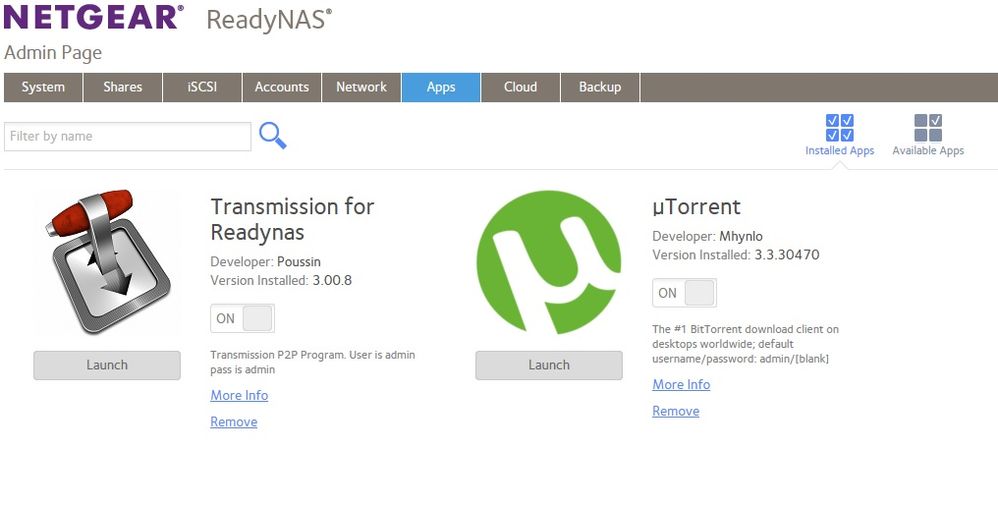

Especially for the log snapshot, I tried to install utorrent. And it was installed successfully!!! I do not understand what's the matter? I am attaching the entire zip of the magazine. Because I don't know where exactly to look at this...

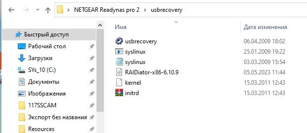

- PaniimSep 12, 2023Aspirant
Good afternoon The problem with installing applications has been successfully resolved. Thanks a lot StephenB !!!
But I think I have another problem. After rebooting the box, I receive a message: the root files are damaged. I checked my hard drive sector by sector. The disc is good. I received two other hard drives from my friend. I do a full factory install but I keep getting the message: corrupt root. This happens after rebooting or turning on the box. The same problem is described here: https://community.netgear.com/t5/Using-your-ReadyNAS-in-Business/Readynas-Ultra-2-stuck-on-booting/m-p/975977#M92655
But I don't understand what you're talking about? What's happened 'mdgm' ?
- StephenBSep 12, 2023Guru - Experienced User
What drives are you using (manufacturer/model)?
It is possible you need to do a USB recovery. You'd use the OS 4.2 tools, but with an OS-6 image.
You'll likely find that in order to get the usbrecovery tool to work, you will also need to install this:
- You need to download and install vcredist_x86.exe from https://www.microsoft.com/en-us/download/details.aspx?id=14431
I have OS6. But should I use the legacy recovery tool?
At first I had an old Hitachi with 160GB. Then I borrowed two 500GB Seagates from a friend. To check the box. With my old Hitachi 160 there was an error - corrupt root. I borrowed hard drives from a friend and did a full reset to factory settings. I made a raid array mirror. Then I rebooted the box. And again the inscription came out - corrupt root.
- SandsharkSep 12, 2023Sensei
Yes, to do a USB recovery of a legacy system upgraded to OS6, you must use the OS 4.2.x recovery tool and instructions with an OS6 image. Unlike when converting to OS6 initially, the image doesn't need to be modified. It does need to be named in a way the tool expects it, such as RAIDiator-x86-6.10.9.
- PaniimSep 13, 2023Aspirant
I don't know why, but I couldn't boot the box from the USB flash drive. I tried different ports on the box. I tried two different flash drives. But the box did not load from them.
At one point, the box loaded normally, without the inscription - corrupt root. And I was able to install the firmware locally. It seems that now it works and the inscription - corrupt root does not appear.
Please tell me, is it possible to replace the RAM module in the box with a 2GB module? My box has a 1GB module installed...
- StephenBSep 13, 2023Guru - Experienced User
It is, and I do recommend doing that with OS-6. The simplest thing to do is look at the existing RAM and get something compatible.
- SandsharkSep 14, 2023Sensei
The legacy NAS are quite picky about what USB drives they'll work with, and it does only work with the front port. But it's moot for now since it seems you finally got things worked out.
