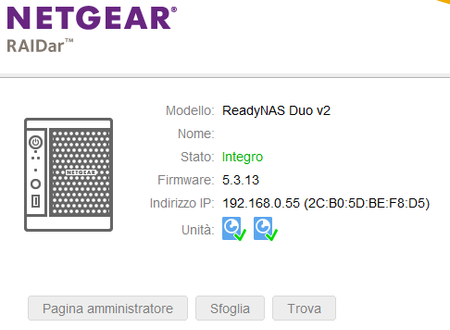

Buongiorno, non riesco più ad accedere alla NAS. I parametri della rete non sono cambiati, il router è sempre lo stesso. Il programma raidar (v.6.5.0) rileva correttamente la NAS e visualizzo l'i...

The problem is that your NAS only supports TLS 1.0 - which current browsers have deprecated.
Start by installing firefox. Set security.tls.version.min to 1 (browse to about:config and search for the setting).
After that you will be able to log into the NAS dashboard. Once you have regained access, install this add-on:
The add-on will add TLS 1.2 support to the NAS web server - letting you access the NAS with any browser.
Test that be changing security.tls.version.min back to the default setting, and then confirm that you can still log into the dashboard.
