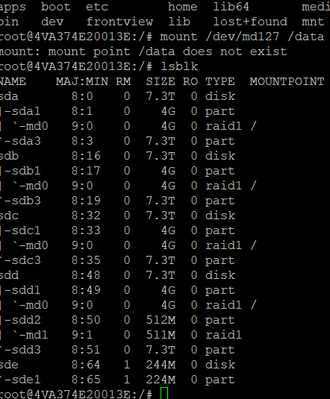

I can get in to the tech support mode but it seems like no basic commands work like ll or dir including lsblk.

You could try
rnutil chrootThat will start raid, mount the actual OS partition, and then chroot. That will give you all the commands.
But If there is some active malware still running in the OS, that could try to spread to other devices on your network.
If you then wanted to attempt to mount the data volume, then you would enter
btrfs device scan mount /dev/md127 /data(the above assumes your data volume is /data)

- markbad311Dec 26, 2023Aspirant
It doesn't appear to be /data I tried to mount and it failed. I reinstalled the OS and was able to get in to the /admin page but there are no volumes.
Not sure what to do next here... I don't want to recreate volumes because I do not want to lose data, but if they simply dropped them and I could "mount" them and I could see my data that would be ideal, my fear is that I will be taking these disks out to run a recovery on them anyways.
